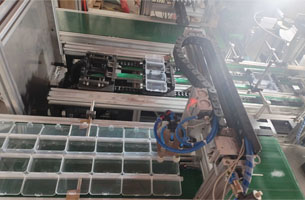

Figure 1 - Mechanical structure
Figure 2 - Drive structure
Figure 3 - Servomotor installation
